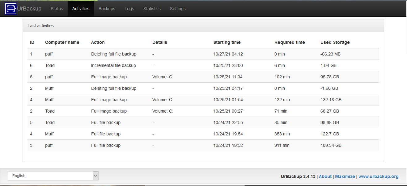

Now for the third time, after installation and transferring the server’s identity code to the client’s server_idents file, the server finds the clients and performs backups.
Notice how quickly it deleted puff’s full file backup, just three days.
This is where it locks up and does nothing further.
Following are two of the clients backup records.
Everything worked just great.

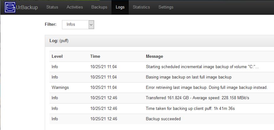

Here are the logs in chronological order.
You can see that it found all three clients and did full file backups within an hour or two.
Then it did image backups.
Then the last thing it did was one incremental file backup before it goes off-the-air.
Also notice the second screen shot of the Status page.
This screen shot was taken yesterday yet, nothing has changed a day later.
Today’s display is identical to yesterday’s, it’s as if the background server has gone of-line but still responds to the GUI.
This is the way it ends. Now, three times in a row.
The server is frozen and no more backups will be made.

Now that I have nuked it all and created a first jail with DHCP selected, no more ooze.
So far, Urbackup works like it should.
It remains to be seen if it peters out in a few days, never to backup again, like the plugin version.
I will post again when I know more
All for now
God News.
Urbackup is still running O.K.
Installing via the Freenas instructions linked above works.
I’ve tried a few and have yet to have any Truenas plugin work successfuly.
I will avoid the plugins in the future and do it by hand.
Thanks to all for your help.
