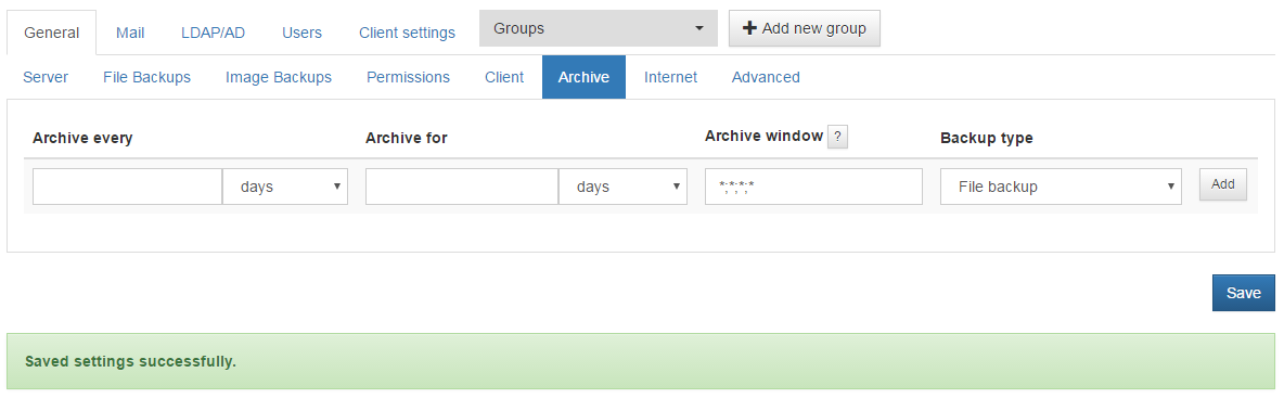

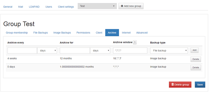

Groups for client settings

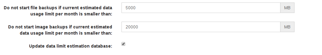

Could you please give us more explanations about these new parameters :
Which values should we use to ensure that our office branch VMs WAN backups will always start ?
Regards,
uroni
December 16, 2016, 11:52am
7
This affects only Windows 10 clients with Wifi set to “metered” or connected via mobile device hotspots.

Thanks !
BTW, creating an automatic image archive rule now works, but i’m unable to delete it after creating.
Also, creating an archive rule for “Full image backup” becomes “Image backup” after leaving / return in settings :
If i click on “Logs” and then go back in “Settings > Archive” :
Clicking on “Delete” and then on “Save” doesn’t remove the rule :
Regards,
uroni
December 18, 2016, 5:37pm
18
Hmm, cannot reproduce the deletion issue. Maybe there are additional steps to reproduce?
Okay.
I’ve deleted all rules directly from the database and made some new tests.
It looks like archive rules at “General” level (i.e Settings > General > Archive) is buggy,
Setting a first rule for “Full image backup type” then click on “Add” button :
Ok, the rule is added in GUI. Click on “Save” :
Rule disappear from GUI :
BUT is present in database :

Adding the same rule at Group level seems to work fine but still show “Image backup” instead of “Full image backup” :
sqlite> select * from automatic_archival;
id next_archival interval interval_unit length length_unit backup_types clientid archive_window
1 0 2419200 w 31534272 m 4 0 18;*;*;7
2 1482146247 2419200 w 31534272 m 4 -1 18;*;*;7
sqlite>
And rule is well reported on group members :
EDIT :
General archive rule seems to be visible after adding the group level rule.
Clicking on “Delete” :
And then “Save” :
Rule still here in GUI
But is deleted from database :
sqlite>
Regards,
Found that in fact, “Group level” archive rules are also displayed in “General settings” archive rules …
Which i think is not normal …
