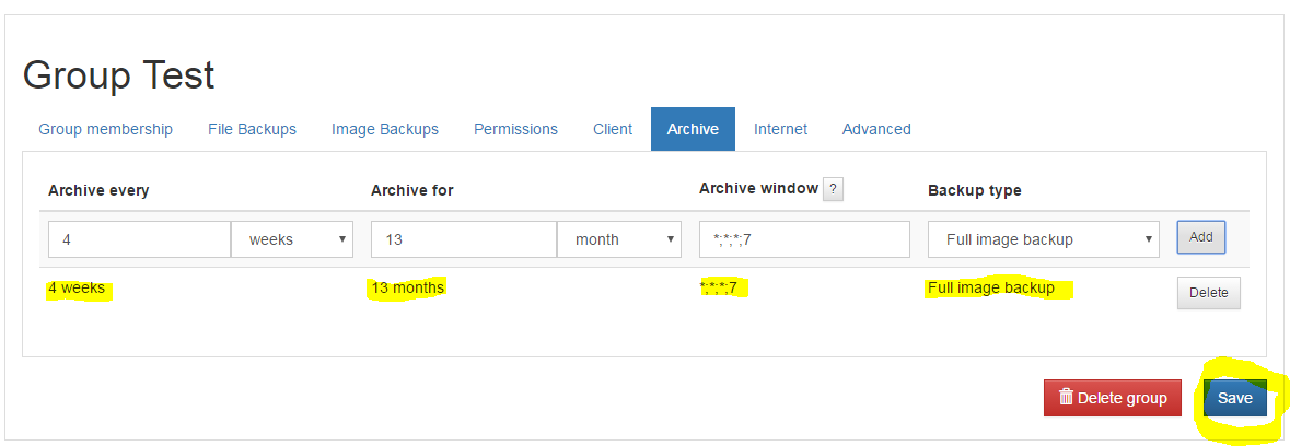

It looks like archiving rules on groups are not retained :
After click on “Save” :
This doesn’t occurs on a standalone client :
Regards,
