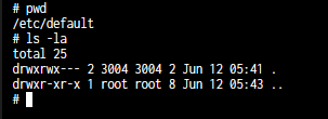

OK, so i mounted the container folder /etc/default on the host server.
Then, I opened a terminal inside the container and when i tried to open the file /etc/default/urbackupsrv it was nowhere to be found.
I guess my original question remains, how can i make the process urbackupsrv be run by user “root” when urbackup is installed via a docker container?
