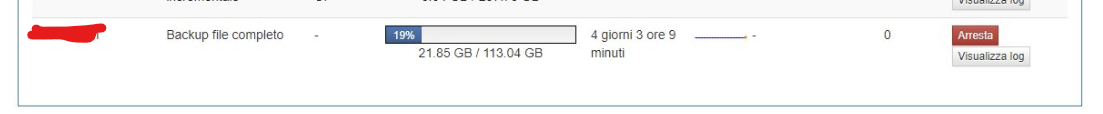

this appears to be a solution (see screenshot). Yes … not elegant solution but decisive. With almost 20 client doing backups every day, I think it’s difficult. Thanks for your help. Can anyone help us?
