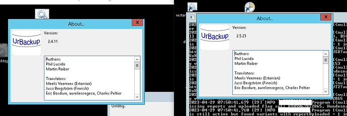

I did check the client versions, the servers with Client Version 2.4.11 not make problems, the server witch i did upgrade to 2.5.23 when i made the upgrade to server 2.5.30 are the one with problems. Maybe it is the Client? Deleting the Backups is no option!
What happen if i go back to client 2.4.11?
