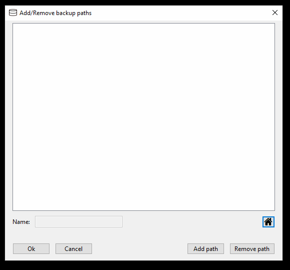

after i’ve updated the server i’ve noticed that on our servers the client was updated and all the backup paths configured are lost.
I’ve read here that you have reworked the settings but why all settings i’ve configured is lost? Can i recover them?
We leave in all our installations the backup path settings on clients. Now what i have to do to not lost settings in others installations?
Best regards
UPDATE:
Here is what the client show. I’ve tried to switch with the new icon but the list is always empty
Same issue here.
The paths are there, but they aren´t visible from GUI.
If you go with command line: urbackupclient_cmd list-backupdirs they appear
Thanks. I will configure them in this manner waiting a fix

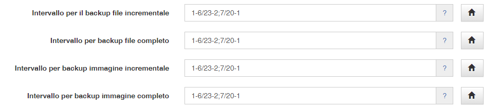

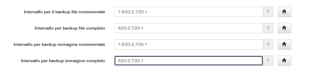

Another problem.
When i modify the backup interval separately isn’t working correctly. It saves one interval for all after reload the page and reenter in the client options.
Here are the examples before and after save and reload (Some time after same appear work but is not and some times reload directly with the wrong configuration)
