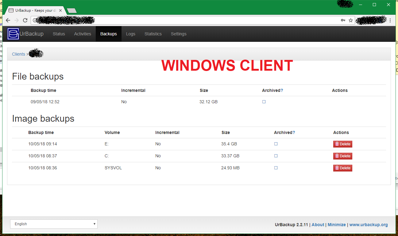

Hi Jejamin,
I already rebooted both, server (after all the running backups end) and some of the clients (that I’ve updated yesterday). Still not every client are showing the restore button (just the Microsoft Windows ones). In total, are more than 30 clients configured.
The server is running over an Ubuntu 16.04 with btrfs for backup storage and using UrBackup version 2.2.11. All clients are using the version 2.2.5, except one (legacy, using 1.4.11). All of the clients are headless and all of the Linux clients are set with the “RESTORE=server-confirms” (some screens of server’s web interface are attached).
EDIT: I’ve implemented this server this week; I’ll let it run this weekend and check it again on monday, to see if it is some data base index or something like it that is probably running.
Thank you very much; best regards.

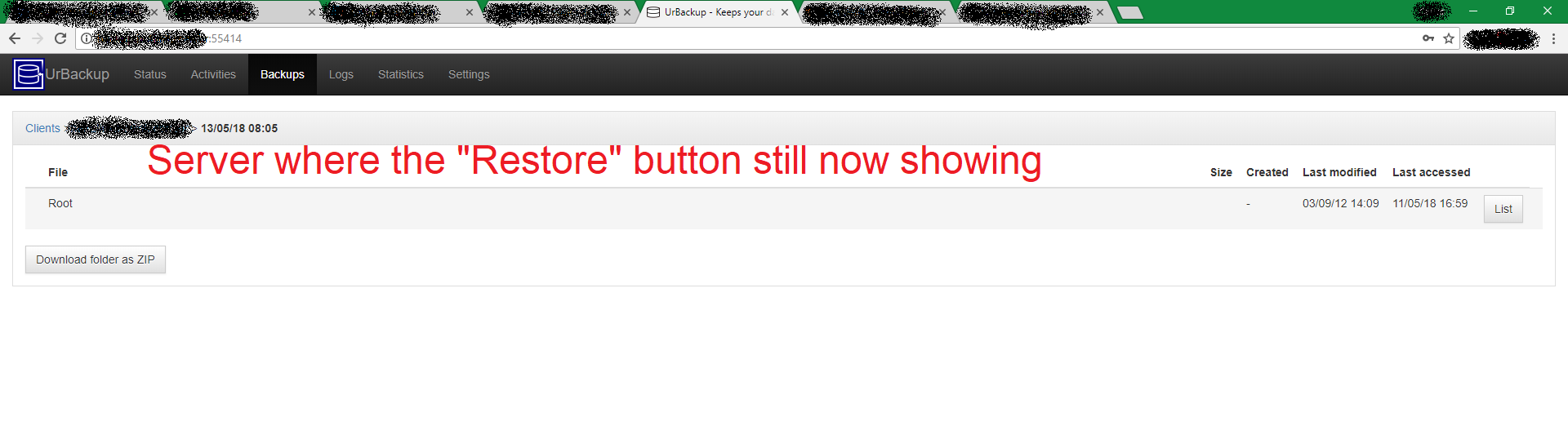

I’ve tried, but nothing changed. When I arrived at work today, it still was without the “Restore” button; I’ve changed the setting to RESTORE=“server-confirms” (with quotes) and restarted the client, nothing changed. So, after that, without any backup running, I’ve restarted the service “urbackupsrv” in the server; after that, most of the clients are now showing the restore button. I said “most” because some clients are still not showing the button, as the images show bellow (just taken - both Linux servers). Couldn’t get the logic behind this, but I think it’s an indexing of somekind behind.
Working server:
Server without the “Restore” button:
