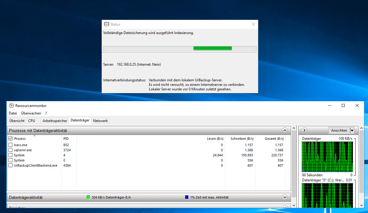

Hello, since December one client won´t backup anymore.
Client is stuck with indexing (even for days!)

Client Windows Server 2016
I am backing up on a NAS (QNAP) which is connected via network share.
Never have had this problem before, also the other clients (5x) are backing up normally.
Can anyone help me?

Maybe the screenshots help:
It looks like task is running but super slowly?
the folder i am trying to data test backup has only abou 60 Files and 10kilobyte.
Or does Urback always index the whole drive, regardless if you just pick 1 Folder in the settings?

Do you have a thread that uses 100% CPU? Could be this fix:
committed 11:16PM - 18 Oct 20 UTC
This one isn’t in the non-CBT client (2.4.11). So if you use the non-CBT client with CBT you’ll get this issue. Solution: Use the CBT client or disable CBT.
No thread with 100% CPU
I don´t use CBT (as far as i know) never purchased a license or activate it. Also on the about screen it shows no option/info for CBT
