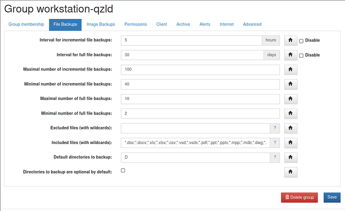

I removed the Ubuntu client and let cleanup finish it off. I removed the group, also. I used the Add new client in Urbackup to add back the linux box. I created a new group, added the new client to that group and entered in the target directories in the “Default directories to backup” field using the settings here.
I forced a Full file backup and it still reports that the first directory from the default group cannot be found. I now have “Directories to backup are optional by default” checked on both Default and new Group File Backups page - No help.

After playing arount again(!) with the default settings, I think I’ve found the solution:
Be sure to set the check on “Directories to backup are optional by default:” on the default File Backup section on settings.

Next, I entered in linux-type directories in the Default group’s default directories to backup and selected the optional check box. I now can backup most of those directories. It appears that this group (even if renamed) is only looking at the Deafult File backup locations and not it’s own settings - making sure the house icon is displayed for Use settings here. One directory would not backup and I need to look into that which may be due to a user’s permission settings.
Now the Windows clients in their own group don’t have files to backup. It’s as if the Default group is the only directory settings considered after updating the Server.
Thanks - I have already checked (and rechecked) all Groups optional by default boxes. No relief here.
OK - so, yes, I have placed all directories (Linux, Windows, etc) in the Default settings still set as optional and that seems to get me going again - I think. Testing with incremental backups is producing seemingly large backups (compared to some recently previous backups of same clients).
