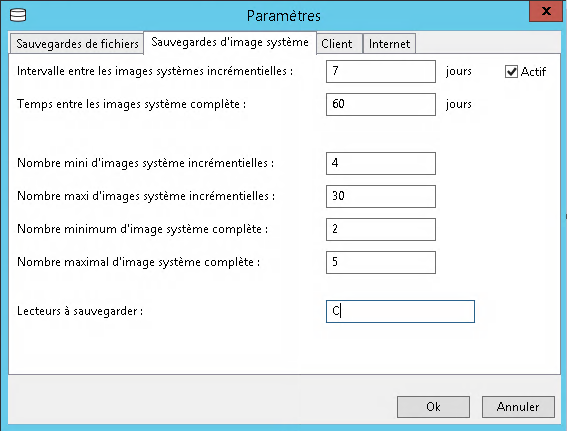

Yes SMART test was done on the client. And I made a chkdsk with success on disk C:
Capture d’écran de 2021-05-28 15-21-15

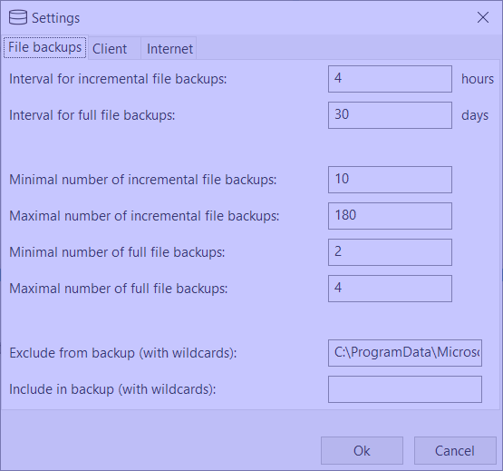

Thanks for that. The UI looks different from mine (I’m also running v2.4.11)
Now, I have image files disabled on the server side at present, so that might be a factor, but I don’t know.
I’m running my server on Windows 2019, and my client on Windows 10, Build 19043.
I haven’t run image backups in a couple months, but it was working for me across all my clients.
