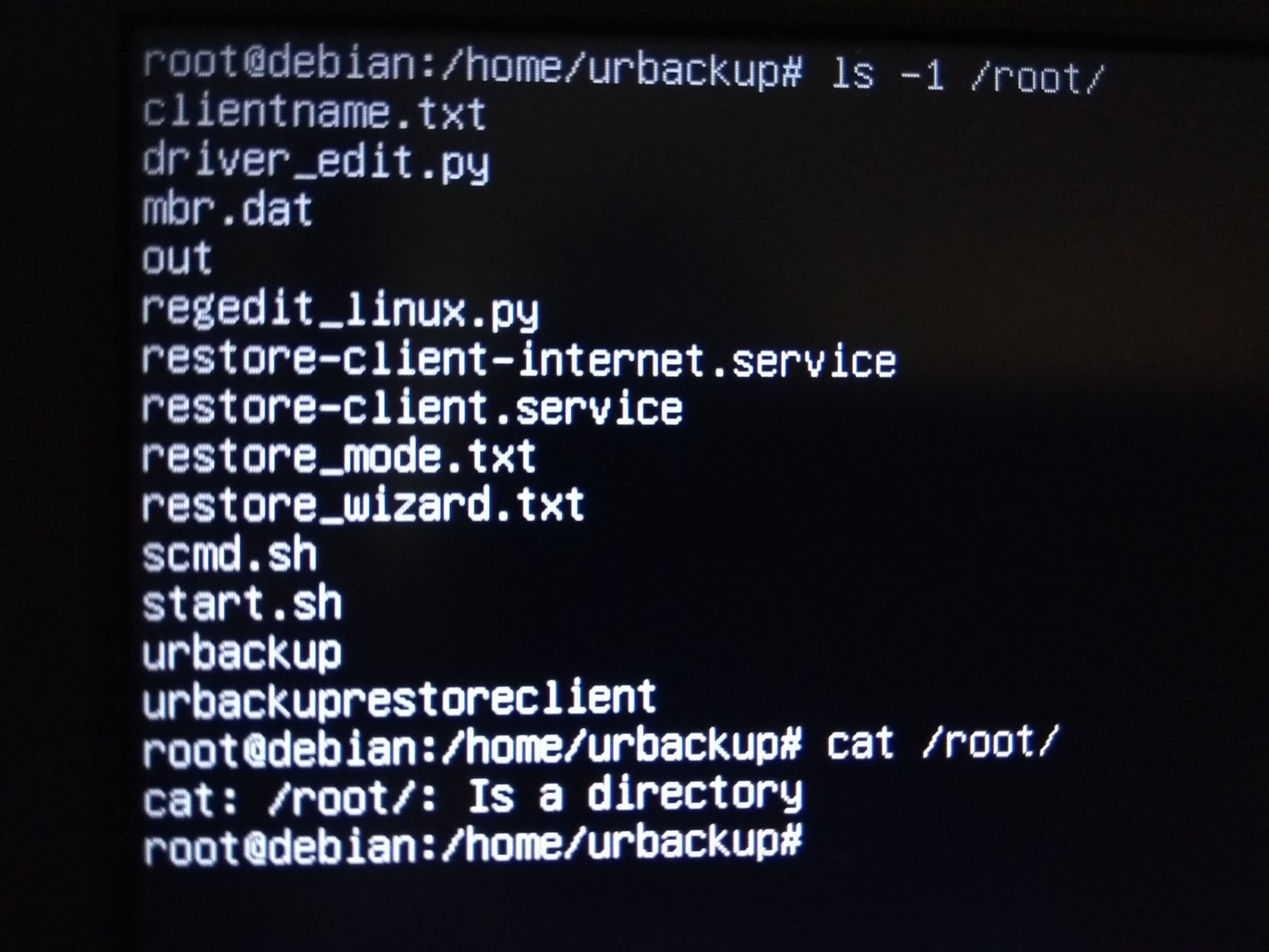

Hi
more clearly , can you type CTRL+ALT+F2 (that ll switch to console)
then type : parted -l (that ll show the partitions ),
then type : lsblk (that ll also show the partitions, but differently ),
please screenshot that and post it on the forums
then either
transfert the files in /root/ and post them on the forums
or if you have no idea how to do that, then.
type ls -1 /root/ to show the list of files
then : cat /root/
then screenshot that and upload it
You could also upload the .mbr file. That would allow us to look at the partition table as well.
Now I have the exactly same error on 2nd PC…here are the screen shots and .mbr file from both
Urbackup mbr.zip (1.3 KB)
Sorry but I am not very linux oriented just know some basics :slight_smile:
I’d have to have a detailed look at the mbr file if this isn’t the case, but it looks like you are trying to restore a extended partition. Those are not completely supported (see Limitations at https://www.urbackup.org/features.html ).
What you can do is use parted, cfdisk or a boot disk with gparted and create the D partition manually, then restore it via the command line. Just make sure the manually created D partition is large enough.
