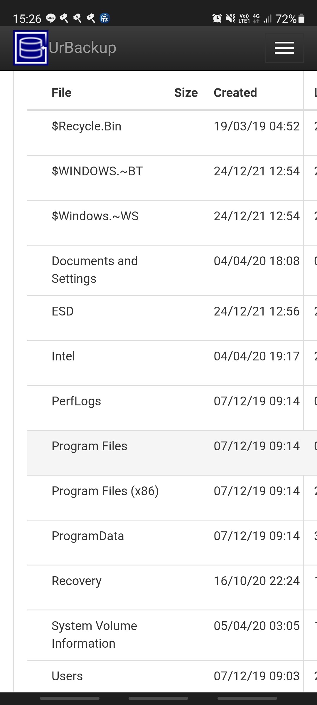

For me, this is available when I browse the backup from the GUI to check:

In my case it was because I was backing up C:\Users and that included “C:\Users\All Users”, which is a symlink to ProgramData.
Have you tried finding in your backups that folder and see if the contents of ProgramData are there?
