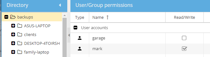

Then in the OMV Shared Folders interface, the ACL for the /backups folders is set to RW for user mark:
Personally, I have a little trouble understanding the difference between privileges and the ACL. I may have tried the one, failed, then tried the other…
