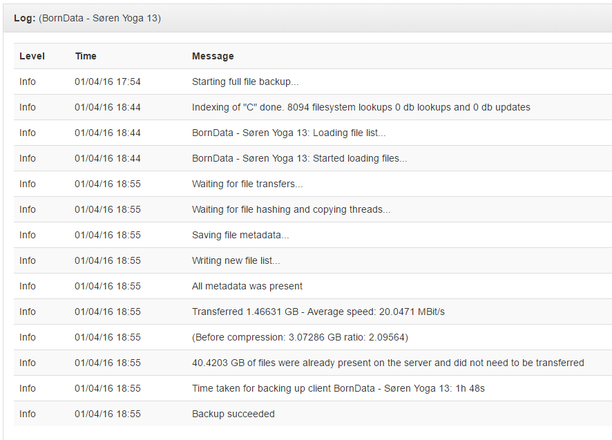

I have updated to 2.0.8 server and on my windows 10 to 2.0.7 client.
Now I get this error:
ERROR: Client calculated hash of "/media/backup/urbackup//BornData - Søren Yoga 13/160331-0902/C/Users/sr/AppData/Local/Google/Chrome/User Data/Default/GPUCache/data_3" differs from server calculated hash. This may be caused by a bug or by random bit flips on the client or server hard disk. Failing backup.
WARNING: Error adding sparse file entry. Could not read hash from /media/backup/urbackup//BornData - Søren Yoga 13/160331-0902/.hashes/C/Windows.old/Users/Søren/OneDrive/Billeder/Filmrulle/IMG_20150214_223402.jpg
WARNING: Error adding sparse file entry. Could not read hash from /media/backup/urbackup//BornData - Søren Yoga 13/160331-0902/.hashes/C/Windows.old/Users/Søren/OneDrive/Billeder/Filmrulle/IMG_20150418_213243.jpg
WARNING: Error adding sparse file entry. Could not read hash from /media/backup/urbackup//BornData - Søren Yoga 13/160331-0902/.hashes/C/Windows.old/Users/Søren/OneDrive/Billeder/Filmrulle/IMG_20150517_101850.jpg
WARNING: Error adding sparse file entry. Could not read hash from /media/backup/urbackup//BornData - Søren Yoga 13/160331-0902/.hashes/C/Windows.old/Users/Søren/OneDrive/Billeder/Filmrulle/IMG_20150604_101853.jpg
WARNING: Error adding sparse file entry. Could not read hash from /media/backup/urbackup//BornData - Søren Yoga 13/160331-0902/.hashes/C/Windows.old/Users/Søren/OneDrive/Billeder/Filmrulle/IMG_20150604_102142.jpg
WARNING: Error adding sparse file entry. Could not read hash from /media/backup/urbackup//BornData - Søren Yoga 13/160331-0902/.hashes/C/Windows.old/Users/Søren/OneDrive/Billeder/Filmrulle/IMG_20150612_193941.jpg
WARNING: Error adding sparse file entry. Could not read hash from /media/backup/urbackup//BornData - Søren Yoga 13/160331-0902/.hashes/C/Windows.old/Users/Søren/OneDrive/Billeder/Filmrulle/IMG_20150624_101114.jpg
WARNING: Error adding sparse file entry. Could not read hash from /media/backup/urbackup//BornData - Søren Yoga 13/160331-0902/.hashes/C/Windows.old/Users/Søren/OneDrive/Billeder/Filmrulle/IMG_20150630_224533.jpg
WARNING: Error adding sparse file entry. Could not read hash from /media/backup/urbackup//BornData - Søren Yoga 13/160331-0902/.hashes/C/Windows.old/Users/Søren/OneDrive/Billeder/Filmrulle/IMG_20150707_124412.jpg
WARNING: Error adding sparse file entry. Could not read hash from /media/backup/urbackup//BornData - Søren Yoga 13/160331-0902/.hashes/C/Windows.old/Users/Søren/OneDrive/Billeder/Filmrulle/IMG_20150716_203702.jpg
WARNING: Error adding sparse file entry. Could not read hash from /media/backup/urbackup//BornData - Søren Yoga 13/160331-0902/.hashes/C/Windows.old/Users/Søren/OneDrive/Billeder/Filmrulle/IMG_20150716_211145.jpg
WARNING: Error adding sparse file entry. Could not read hash from /media/backup/urbackup//BornData - Søren Yoga 13/160331-0902/.hashes/C/Windows.old/Users/Søren/OneDrive/Billeder/Filmrulle/IMG_20150716_223304.jpg
WARNING: Error adding sparse file entry. Could not read hash from /media/backup/urbackup//BornData - Søren Yoga 13/160331-0902/.hashes/C/Windows.old/Users/Søren/OneDrive/Billeder/Filmrulle/IMG_20150928_215458.jpg
WARNING: Error adding sparse file entry. Could not read hash from /media/backup/urbackup//BornData - Søren Yoga 13/160331-0902/.hashes/C/Windows.old/Users/Søren/OneDrive/Billeder/Filmrulle/IMG_20151008_121232.jpg
WARNING: Error adding sparse file entry. Could not read hash from /media/backup/urbackup//BornData - Søren Yoga 13/160331-0902/.hashes/C/Windows.old/Users/Søren/OneDrive/Billeder/Filmrulle/VID_20150828_203753.mp4
ERROR: Fatal error during backup. Backup not completed
ERROR: FATAL: Backup failed because of disk problems

This is a new server install (not upgrade) of a UrBackup server >= 2.0.5 (tree hashing) and the client uses “block differences - hashed” transfer mode?
Then I ran incremental backup:
ERROR: Client calculated hash of “/media/backup/urbackup//BornData - Søren Yoga 13/160401-1926/C/Users/sr/AppData/Local/Google/Chrome/User Data/Default/GPUCache/data_3” differs from server calculated hash. This may be caused by a bug or by random bit flips on the client or server hard disk. Failing backup.
WARNING: Error adding sparse file entry. Could not read hash from /media/backup/urbackup//BornData - Søren Yoga 13/160401-1926/.hashes/C/Windows.old/Users/Søren/OneDrive/Billeder/Filmrulle/IMG_20150214_223402.jpg
WARNING: Error adding sparse file entry. Could not read hash from /media/backup/urbackup//BornData - Søren Yoga 13/160401-1926/.hashes/C/Windows.old/Users/Søren/OneDrive/Billeder/Filmrulle/IMG_20150418_213243.jpg
WARNING: Error adding sparse file entry. Could not read hash from /media/backup/urbackup//BornData - Søren Yoga 13/160401-1926/.hashes/C/Windows.old/Users/Søren/OneDrive/Billeder/Filmrulle/IMG_20150517_101850.jpg
WARNING: Error adding sparse file entry. Could not read hash from /media/backup/urbackup//BornData - Søren Yoga 13/160401-1926/.hashes/C/Windows.old/Users/Søren/OneDrive/Billeder/Filmrulle/IMG_20150604_101853.jpg
WARNING: Error adding sparse file entry. Could not read hash from /media/backup/urbackup//BornData - Søren Yoga 13/160401-1926/.hashes/C/Windows.old/Users/Søren/OneDrive/Billeder/Filmrulle/IMG_20150604_102142.jpg
WARNING: Error adding sparse file entry. Could not read hash from /media/backup/urbackup//BornData - Søren Yoga 13/160401-1926/.hashes/C/Windows.old/Users/Søren/OneDrive/Billeder/Filmrulle/IMG_20150612_193941.jpg
WARNING: Error adding sparse file entry. Could not read hash from /media/backup/urbackup//BornData - Søren Yoga 13/160401-1926/.hashes/C/Windows.old/Users/Søren/OneDrive/Billeder/Filmrulle/IMG_20150624_101114.jpg
WARNING: Error adding sparse file entry. Could not read hash from /media/backup/urbackup//BornData - Søren Yoga 13/160401-1926/.hashes/C/Windows.old/Users/Søren/OneDrive/Billeder/Filmrulle/IMG_20150630_224533.jpg
WARNING: Error adding sparse file entry. Could not read hash from /media/backup/urbackup//BornData - Søren Yoga 13/160401-1926/.hashes/C/Windows.old/Users/Søren/OneDrive/Billeder/Filmrulle/IMG_20150707_124412.jpg
WARNING: Error adding sparse file entry. Could not read hash from /media/backup/urbackup//BornData - Søren Yoga 13/160401-1926/.hashes/C/Windows.old/Users/Søren/OneDrive/Billeder/Filmrulle/IMG_20150716_203702.jpg
WARNING: Error adding sparse file entry. Could not read hash from /media/backup/urbackup//BornData - Søren Yoga 13/160401-1926/.hashes/C/Windows.old/Users/Søren/OneDrive/Billeder/Filmrulle/IMG_20150716_211145.jpg
WARNING: Error adding sparse file entry. Could not read hash from /media/backup/urbackup//BornData - Søren Yoga 13/160401-1926/.hashes/C/Windows.old/Users/Søren/OneDrive/Billeder/Filmrulle/IMG_20150716_223304.jpg
WARNING: Error adding sparse file entry. Could not read hash from /media/backup/urbackup//BornData - Søren Yoga 13/160401-1926/.hashes/C/Windows.old/Users/Søren/OneDrive/Billeder/Filmrulle/IMG_20150928_215458.jpg
WARNING: Error adding sparse file entry. Could not read hash from /media/backup/urbackup//BornData - Søren Yoga 13/160401-1926/.hashes/C/Windows.old/Users/Søren/OneDrive/Billeder/Filmrulle/IMG_20151008_121232.jpg
WARNING: Error adding sparse file entry. Could not read hash from /media/backup/urbackup//BornData - Søren Yoga 13/160401-1926/.hashes/C/Windows.old/Users/Søren/OneDrive/Billeder/Filmrulle/VID_20150828_203753.mp4
