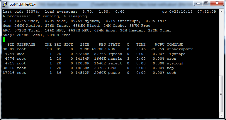

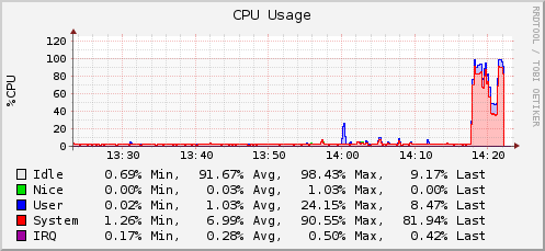

The server that I’m testing in my office is a Quad Core Xeon, with URBackup server running and idle the CPU is at 98% idle, when I initiate a image backup from a single 100% usage and its starves enough resources from the iscsi that it breaks my connections.
