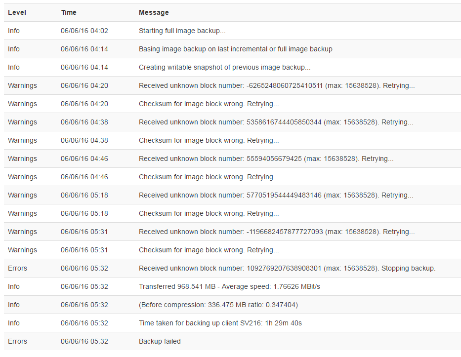

For information, full backup image failed after upgrading server to 2.0.25 and client to 2.0.21 (autoupdate from the server) with error :
Report:
( 3 infos, 0 warnings, 3 errors )
2016-06-02 18:04:46(info): Starting full image backup...
2016-06-02 18:04:48(info): Basing image backup on last incremental or full image backup
2016-06-02 18:04:48(error): Could not read MBR
2016-06-02 18:04:48(error): Cannot retrieve master boot record (MBR) for the disk from the client.
2016-06-02 18:04:48(info): Time taken for backing up client SV201: 2s
2016-06-02 18:04:48(error): Backup failed
Restarting the UrBackup service on the client fix the problem.

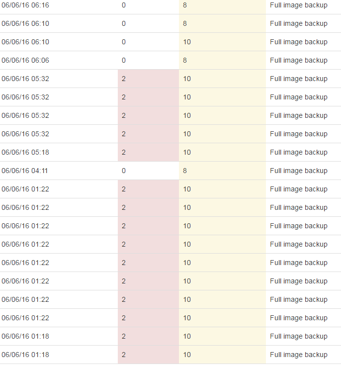

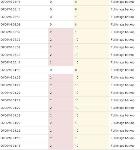

Again this morning, lot of clients full image backup have Warning and Errors :
All with some wrong block messages like this :
Should it be a BTRFS issue (going to try a btrfsck …) ? Database issue ? Client issue ?
Regards,
