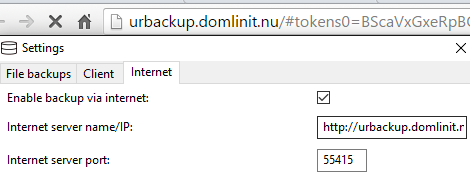

I Access The webui through nginx reverse proxy with HTTPS on Port 443
You mean the internet server port setting on the internet tab?
It’s default 55414
Or do you mean that I should add it to the setting Internet server name/IP on the same tab?
I could try it, will it be synked to my clients?

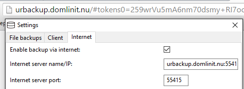

Tried it out.
Adding the port to the Internet server name/IP: did not work.
I’m, confuessed (that is my normal state thou)
It dosen’t seam to matter what I put on the client?
Full URL: http://urbackup.domlinit.nu:55414/
or nothing at all?
Both are on a client on the inside of my LAN and I’m using the access/restore on the clienticon.
I thought the setting (at least from the server side) was the URL and port the klient should use to find the server?

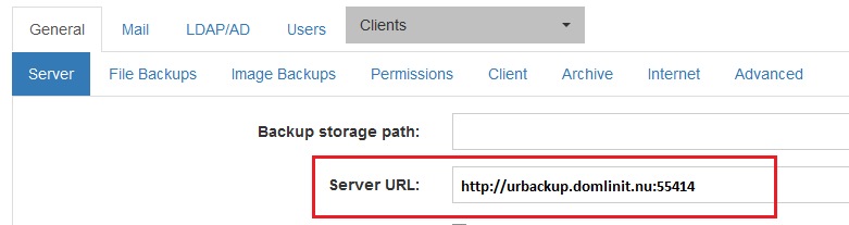

On the server, under General > Server > Server URL, try:
So it looks like this:
Edit:
As others have mentioned, you should run a reverse proxy for HTTPS, but for testing purposes, the above should work.
:thumbsup: Works, it’s was just me who was looking in the wrong place, happens more then I would like to admit :wink:
