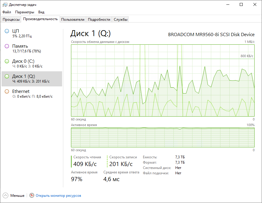

Yes, I’m making a backup of file share with 1,5Tb of small files. And I do not know what to say. URBackup is just SLOW in my case :frowning:
It is a standalone HDD HGST HUS728T8TALE6L4 connected to brand new RAID controller
MegaRAID 9560-8i 4GB
And it is terribly slow:
I will do disk defrag and will write if it will help.
