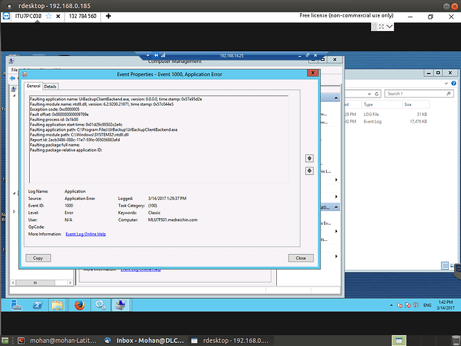

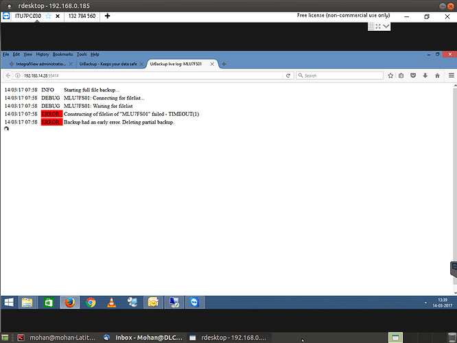

I have installed the client package on W2k12 server, when i try to take to the backup, urbackup client application crashes and backup fails.
My W2k12 OS is update to date.
Tried with re-installing the application but the same issue repeats.

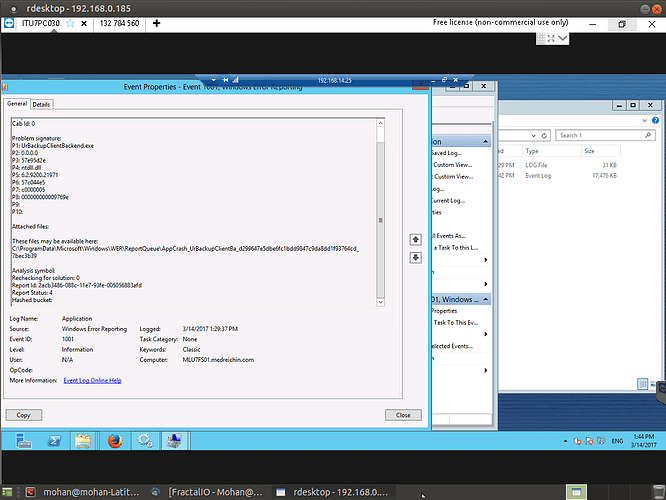

Error at the OS level:
AppCrash_UrBackupClientBa_4d5c1d2958ca1d288579a651a6ba22aa5b2da63e_cab_68f1a88b.tar.gz (2.7 MB)
debug.log (30.1 KB)
Have uploaded debug logs and app crash dump.
