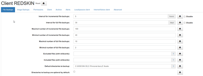

Hello Mikro. Here some screenshoot.
Do you see any mistake in this configuration?

Hello
It should work changing your “Default directories to backup” with this string:
C:\DISEGNI 3D|DISEGNI 3D;C:\Personal docs|Personal docs;E:\Audio|Audio
Let me know if this solve.
Hello Mikro.
Seems it works. But why i’ve the same input on backup server and on client as well?

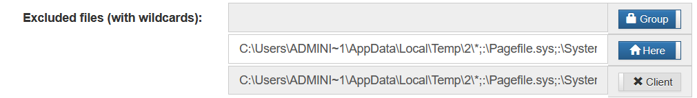

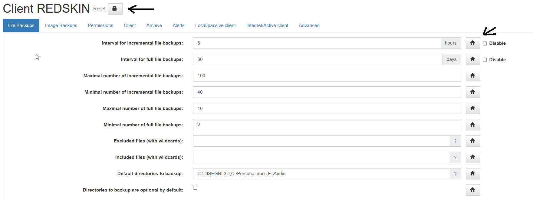

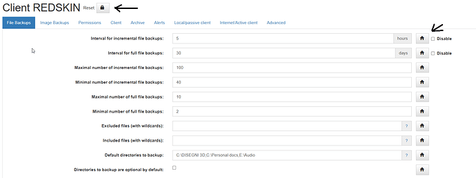

HI.
The icons here close to the arrows. By the way i was trying to change the one close to Reset…but move all the time back to the padlock.
What i need to do to force the client on using the backup server settings?

Ok i got it.
So there are 4 different icons:
This push the client to use your custom setting that you define for it in the box.
this is the setting in your screenshot and you have define incremental file backup every 5 hours.
In case the client is a member of the group, this push the client to use settings you define for the group
In case you’ll allow client to define custom settings and you configure something, you’ll find this icon, this mean that this client is using a setting defined on the client side (not from the server)
Finally if you click on reset you could set a combination of three previous setting by this icon
In this last case you could define different granular settings for each state i describe above and you could activate or deactivate any singular rule.
as you see, there is no rule for the group, there is active rule server side, ad there is client side rule but it’s not active.
Regards
