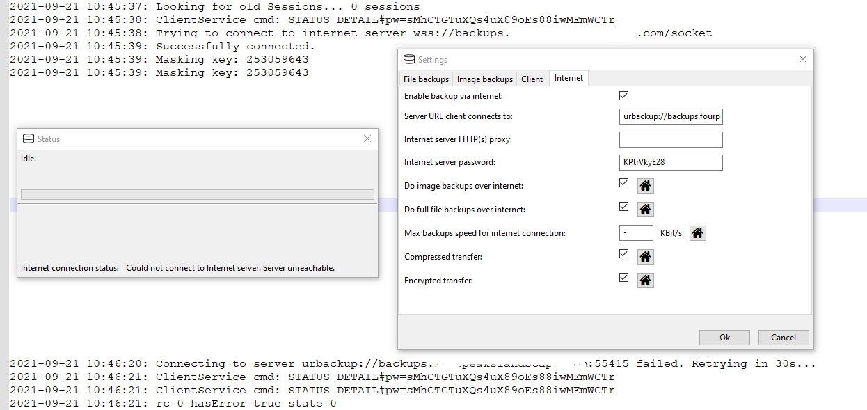

Got it to connect finally, but found an issue.
after connecting properly, the windows client reverts my config to urbackup://backups.f******.com and the logs say failed to connect to said server.
Nevermind, I think I figured it out. I had to update the config on the server portal. Doesnt seem to be reverting now.
