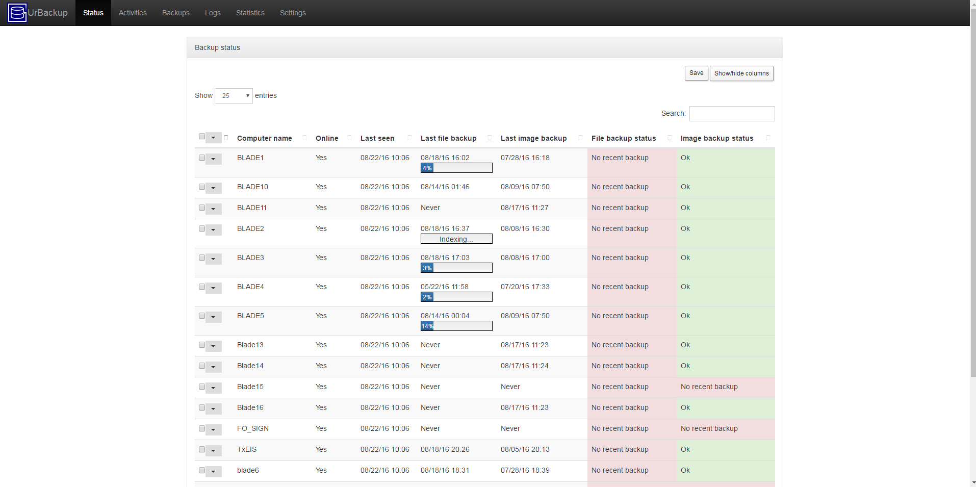

… and now it is showing no file/image backups.
