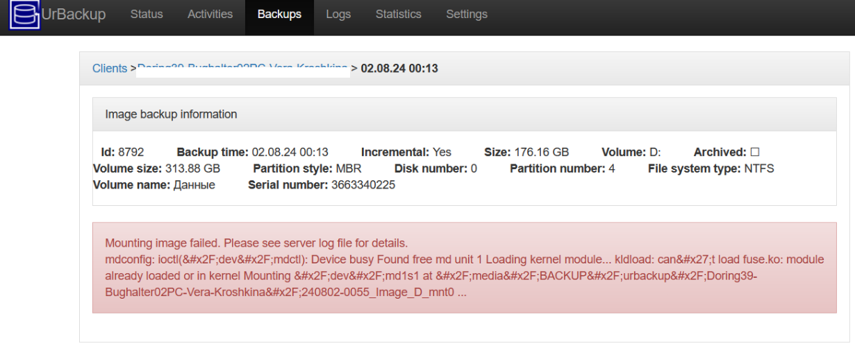

Mounting image failed. Please see server log file for details.
Found free md unit 0 Loading kernel module... kldload: can't load fuse.ko: No such file or directory Mounting /dev/md0s1 at /media/BACKUP/urbackup/Doring39-Bughalter02PC-Vera-Kroshkina/240802-0013_Image_C_mnt0 ... sh: ntfs-3g: not found Mounting failed. Removing md device...
