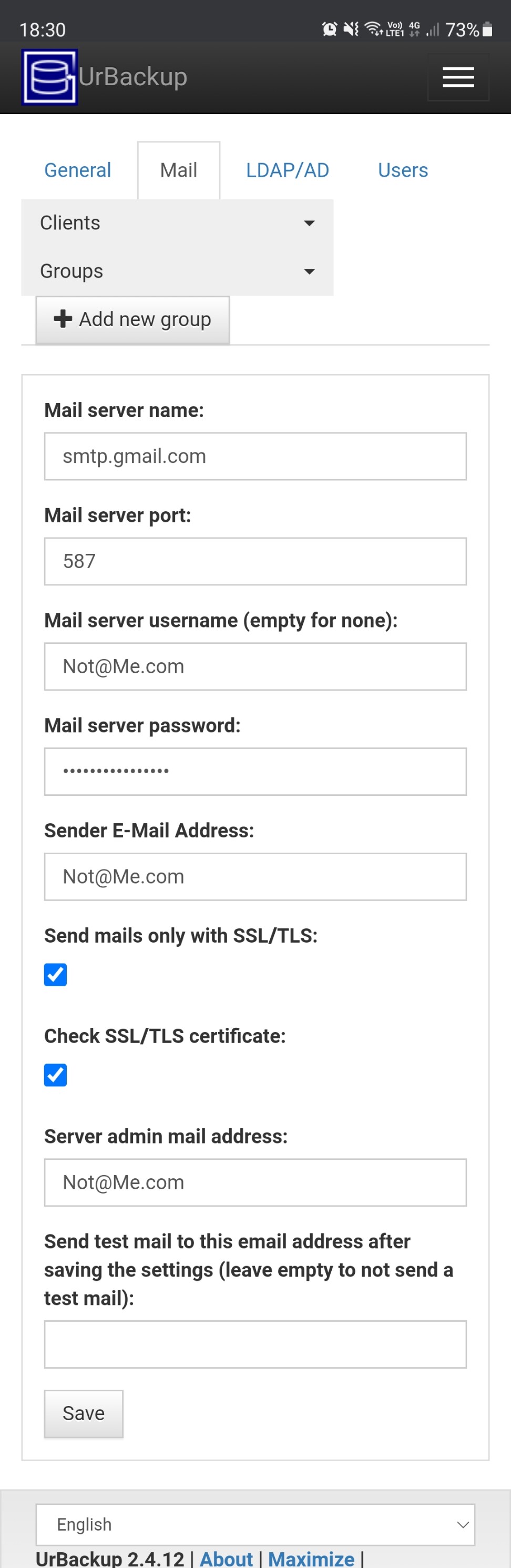

Here is a screenshot of the settings that work for me…
(For security, have replaced the actual e-mail addresses, obvs)
