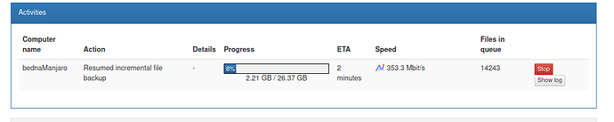

Server 1:
Server 2:
I keep pushing stop, that has fixed it in the past, but not any more, just forces me to now push stop over and over and over, witch means my backups ARE NO LONGER WORKING!!!

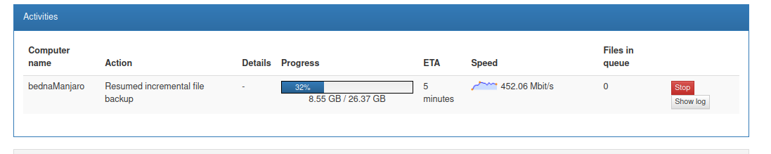

Now, after pushing “stop” on the web insterface SIX TIMES, this is happening, now the EXACT same amount is being uploaded on both servers again, but at a WAY smaller size, THIS IS STILL INCORRECT!!!
Server 1:
Server 2:
The updates from the client should be around 100-300MB!!!
Edit 2
I noticed out of luck that directories that are set to be excluded (on both servers) are NOT excluded and are being uploaded, I exclude f ex “/home/bedna/vmware/*” (pretty hefty size, around 26GB big) so that might be what it was uploading the last backup.
This HAS to be a bug!
