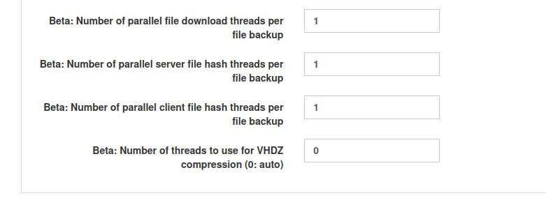

Now as it seems in Urbackup 2.5.x there are a few new settings for it, which for me raises a few questions:
Especially the setting: “Beta: Number of parallel client file hash threads per file backup” which by default is set to 1.
  • If I activate the Parallel client file hashing for the internet clients, but the allowed threads to use is 1, wouldn’t that effectively disable parallel file hashing?
  • Why can we only activate parallel file hashing for internet clients? wouldn’t it also speed up the indexing for local clients?
  • Or when exactly are the files being hashed, during indexing? Or during the transfer phase, and parallel file hashing just means, that while urbackup uploads a chunk, it will parallelly hash the next chunk(s)?
I can’t find any information whatsoever about parallel file hashing in the admin documentation.

W.r.t. the original question. The parallel hashing concerns (from the manual):
If checked the client calculates hashes for each file before the backups (only hashes of changed files are calculated). The file then does not have to be transferred if another client already transferred the same file
Without parallel hashing this is done during indexing. With it is done during backup (in parallel), with one thread. The options are to increase the number of threads, but I wouldn’t touch them currently in production.
