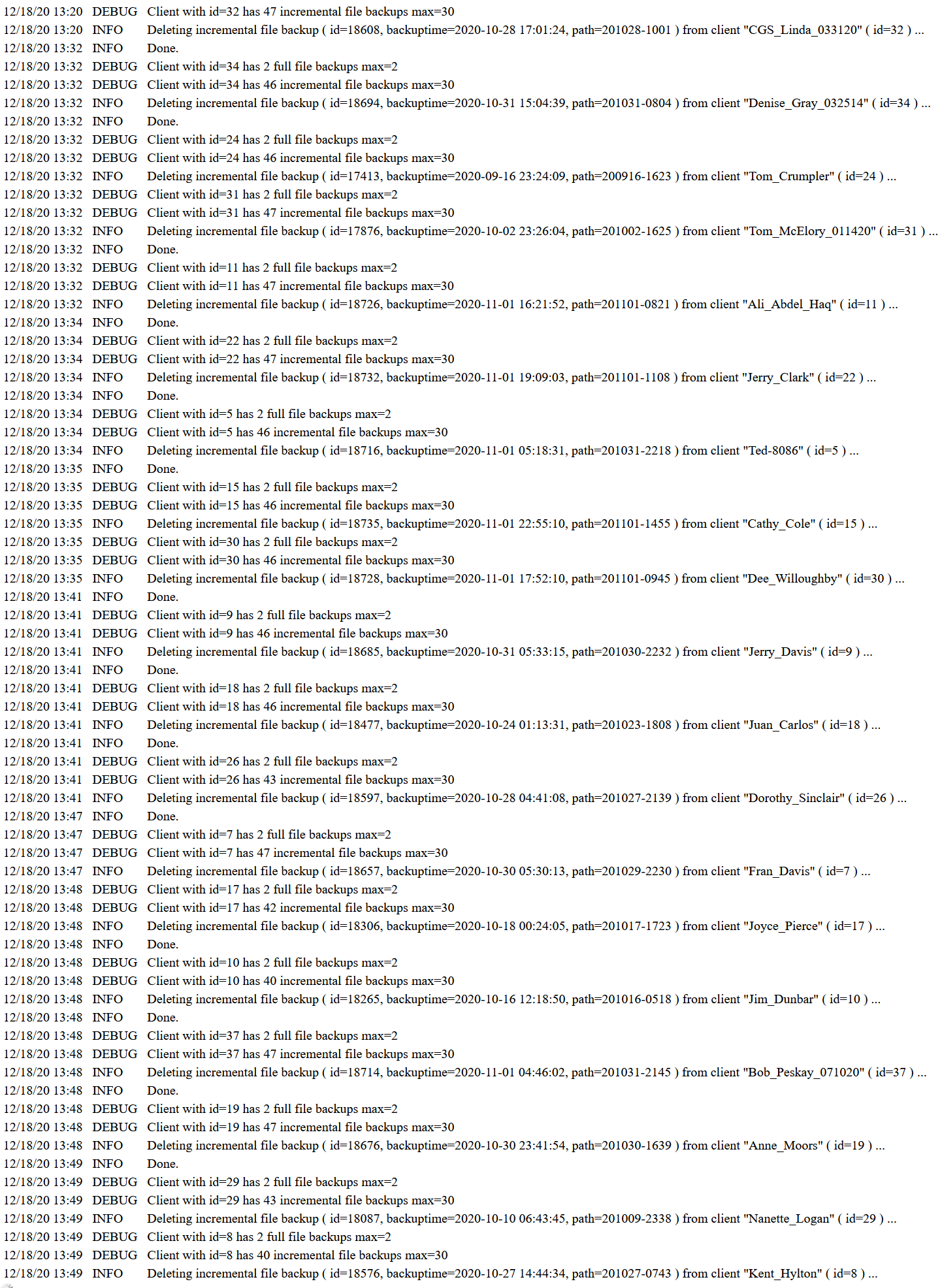

37 clients, almost 14Tb data on statistics. It’s been doing Nightly for almost 2 days straight. Windows 10 for the server.
MegaRaid Storage Manager reports everything good with the RAID. Activity status shows 100% usage on the virtual drive.

Are my incremental too many?
Capture

I think I have too many incremental backups. I’ve reduced the amount to 30. Nightly is taking a week to finish.

Yes I increased the count, figured “why not” when I had so much space on a fast raid. Now I know why not. I did have to break out of the cleaning as clients were red. I’ll just let it run this week, hopefully get back to normal. Thanks for the reply.
I’ve made the same mistake myself. Fast RAID array on a modern dedicated server. I set UrBackup to retain up to 300 daily incrementals for a client that has 20+ million files. Since the files don’t change, I figured “no big deal”. But it means that, every day, the file system and database are updated with millions of new entries. Over time this results in a massive, unwieldy database and billions of hard links on disk, making an eventual cleanup super long despite the server’s fast IO.
I would guess it doesn’t much depend on the number of backups but on the number of files in each backup and the number of backups per day. If you have large number of max incremental backups it just takes a while for the problem to become apparent (the problem being that storage IOPS are too low for both backups + deletion – hard disks are really slow and useless for random IO).
