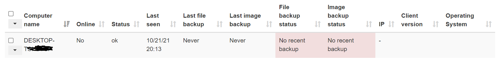

Hi all, I have a client 2.4.11 (Windows) installed on my Win10 pc and I spun up an AWS EC2 VM to backup some files. I have everything configured properly to connect over the internet and my client shows connected but the online status on the server is always “No”.
I opened up ports 55413-55415 TCP inbound and 35623 outbound (UDP) from the AWS server side but no luck. No windows firewall or antivirus on both server or client

  • I restarted after enabling internet mode several times but no luck
  • I’m not sure what you mean by replacing identity files. I tried creating on server and client. Server side by clicking on add and entering client hostname on NAT field. I also downloaded client installer from server web gui, uninstalled client app, re-installed, added client on client side and saw that the client appeared on the servers GUI but still offline
  • I modified inbound rules to allow for only 55414 but no change.
    -I’m pretty sure settings are configured correctly. Proven by me installing client using servers installer and the client showing up on the server but no online.

In the web gui, online: NO
The mentioned ports are opened, i cant start backup from the webgui.
