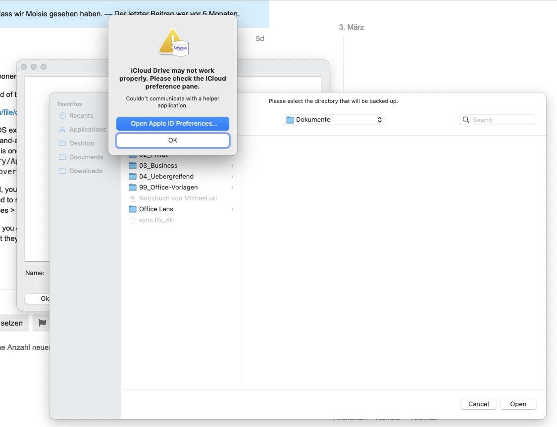

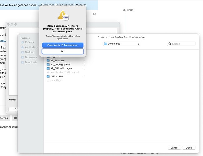

Hey guys, since I updated to Monterey 12.0.1 I cant add backup paths. I’ll get the message in the attachement. Any thoughts on how to fix this?
HI @lucabrasi
I’ve seen that issue too, but under (IIRC) Mojave 10.14.6. I haven’t yet investigated deeper because (IIRC) you can just OK the dialogue, and then press Command-C to go to the top level of your system and drill down into it as normal.
Hope that helps.
Hi Moisie,

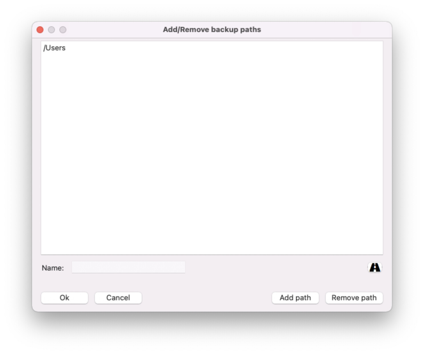

thanks for replying so quickly. I tried to ignore the message and just add a location. Thing is it will not be saved. When I bring up the menu for the locations later it will be empty and Urbackup Admin Interface on the server states that there are no backup path defined. Is there any other way to configure the paths? I was hoping for a config file…
Hi @lucabrasi
Thanks for the feedback. I’ve just tried it on my macOS 12.0.1 system, and it’s working for me as I describe.
I haven’t currently attached it to a Urbackup server - so I wonder if you’ve got yours set to pick up the path from the server rather than use the locally-defined path? What’s your icon at the bottom-right of the Add/Remove backup paths window?
Hm, honestly I was not aware of the posibility to set a mode of path definition at this place. It shows up with the two little pages in the icon on my system. Is there any documentation for those diffentet icons? I can’t find any. I did a fresh install of urbackup and tried the different modes to no avail. And I tried to define one path as a default backup path and still don’t get anything.
