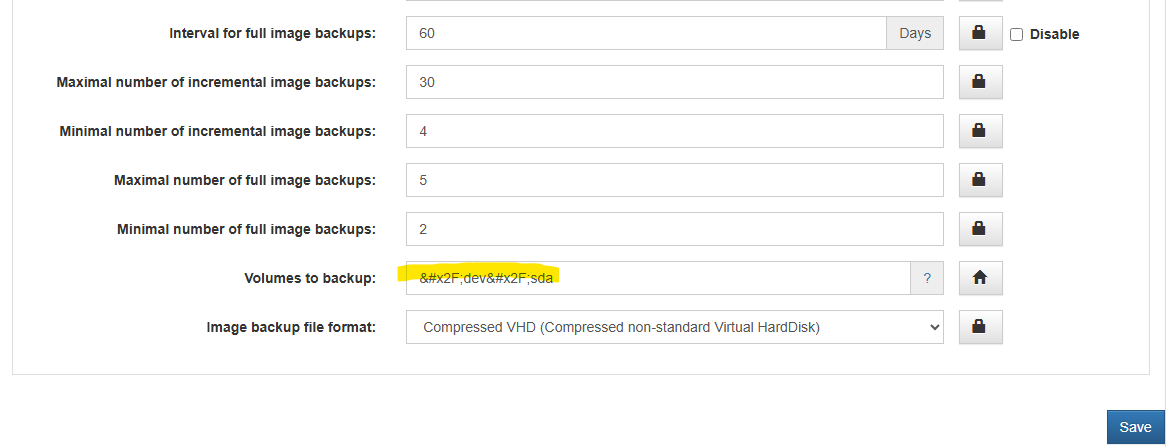

Volume to backup: /dev/sda
This may be an odd question, but why the odd text in the backup? Why not just /dev/sda ?
I know nothing of Image backups on Linux as I stick to file backups. But in my case I just type the path normally.
Dear BatterPudding,
Thanks for pointing this out. I was entering /dev/sda as the volume to backup. After save it and go back and check, it auto become that odd text.
/dev/sda is the full disk, you have to specify the mount paths, so e.g.
/;/home;/boot
that “garbage” after saving is a bug in the UI, I have that, too. It is what you entered but html encoded
