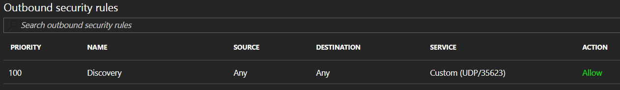

And here are the firewall rules setup on both the client and the server.
UrBackup Server Outbound Rules:
UrBackup Server Inbound Rules:
UrBackup Client Inbound Rules:
UrBackup Client Outbound Rules:
