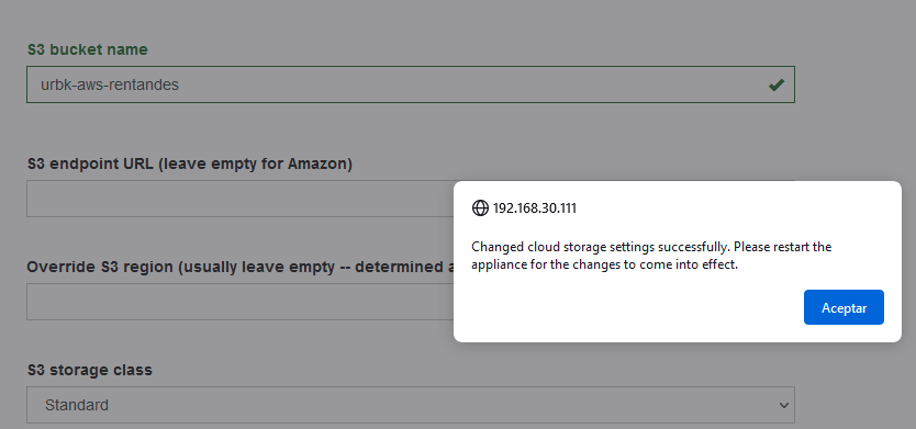

Hello Uroni, I upload files through object explorer from Dreamhost directly, it works,but when I try with S3 Explorer software I can’t connect to DreamObjects S3 Compatible. I decided open an Amazon AWS account and try instrucctions from Infscape. When I configure the storage from urbackup appliance I get this message:
I restart but nothing happens.
Thanks in advance.
Hello Uroni, I reseted my VM and install again the appliance, I try with Amazon S3 and it works, from Dreamhost they recommend not use complete endpoint, only objects-us-east-1.dream.io , now I can connect to bucket to make operations over objects from S3 Explorer.
