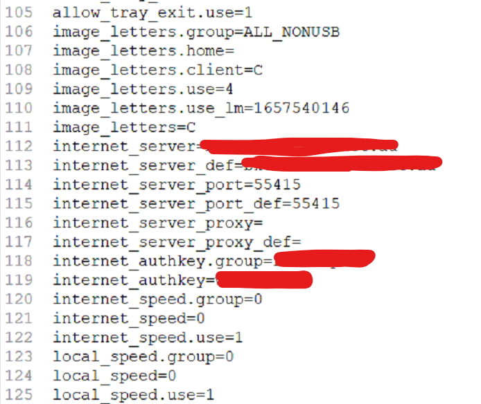

Check that your client file (Windows) called settings.cfg stored in C:\Program Files\UrBackup\urbackup\data\settings.cfg has the right IP (this is why I use a FQDN like bk01.company.au).

But try look here /usr/local/var/urbackup/data/settings.cfg or if you have mlocate installed do a:
$ sudo updatedb
$ sudo locate settings.cfg
Which should tell you where it is.
Definitely restart the service. I did have a random issue once with Windows client where only a full system restart of the client brought it back online. Haven’t had the issue again however.
image_letters.use=1
internet_server=urbackup://IP:55414
internet_server_def=urbackup://IP:55414
internet_server_port=55415
internet_server_port_def=55415
internet_server_proxy=
internet_connect_always.use=1
server_url=http://urbackup://IP:55414
server_url_def=http://urbackup://IP:55414
verify_using_client_hashes.group=false
verify_using_client_hashes=false
I have tried this but no reponse…any thing has to be changed? please let me know
