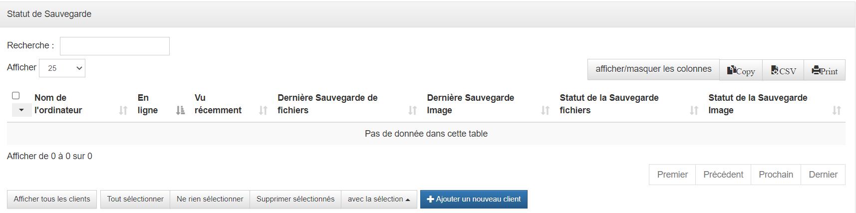

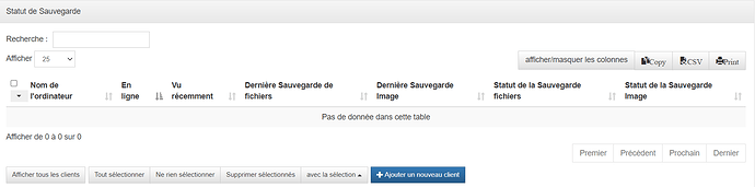

Hi, I have change my home server. Brand new one with debian 11, installation with docker-compose. Client side (windows), I have fully uninstalled and reinstalled the client and the status stays at “waiting” (in french).
I have disabled firewalls both sides, checked with telnet that I could connect to all urbackup tcp ports both sides, the UI on port 55414 works (from my windows pc) and shows no activity. I have checked from inside the container that I could write the mapped disks, and it works.
So the question is why backup does not start?
Thanks for your help.
