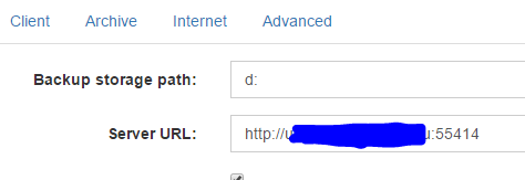

In the image I provided you specify what urbackup will listen to, URL and port, how you get the traffic there in your network is up to you :slight_smile:

I’ve tried to change the port under server/settings/URL, and it should be the full url with http(s):// and everything (http://urbackup.domain.com:55414), and my clients picked it up when they contacted the server for next backup.
So to get it to work outside your network you need to portforward 55414 and 55415 to the urbackup server and change the server/settings/URL to the correct URL and port.

And then you can put https://urbackup.mycompany.com/ into the Server URL field. And now it should be clear that UrBackup has no knowledge of what you put in front of it and how clients can access the web interface, hence it cannot automatically determine the URL.
Note that SCHEME://HOST:PORT/PATH is a URL.
And Server name/IP is just the HOST part of the URL, that is the thing that your DNS server resolves to an IP or the IP itself.

Please see the previous post about where to enter the URL: Client Acces/Restore backup from system tray icon and context meny (2.0.4)
OK. I can see that I was looking at the URL for the client and not the server settings.

OK. I finally changed the server address, in the server settings, to the correct URL. It works as expected. Thanks to all and apologies for my stupidity. Glenn
