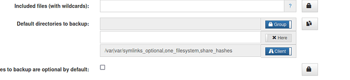

So I took a look at the server, but / isn-t set anywhere as default file backup directory, additionaly the settings of that specific client look like that:
It took a few hours until the initial backup finished. and root / really is not backuped.
I’ve added it now on the server side:
And now it is listed in the directory list
