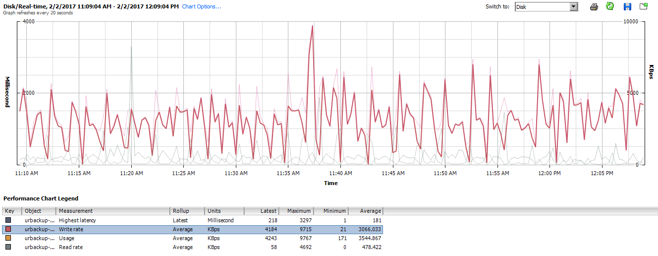

Here’s an example of the disk thrashing going on, with only 1 client backing up:
That seems like a lot of writing going on with just 1 active client :confused:

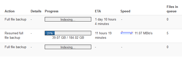

The other two backup clients at Indexing… are sitting at “Waiting for filelist” stage…
