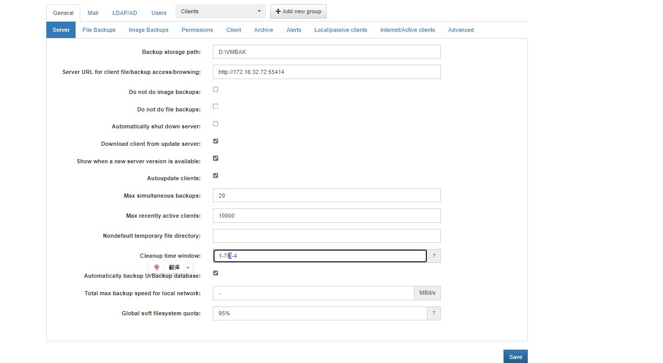

could you also share your Server Gui → General → Server Settings and your Server Gui → Client → Internet/Active client settings

Server Gui → General → Server Settings looks good, but I want to see the Server Gui → Client → Internet/Active client settings (the real client settings of one of these client) and not the general Internet/active client settings. It seems you want do Internet but using a private network?

Looks all good, next Idea would be to activate Debug Logging on Server and Client Site to see what’s going on. Have a look on the manual how to activate debug logging.

- 2023-11-06 09:17:37: SQLite: recovered 116 frames from WAL file C:\Program Files\UrBackup\urbackup\backup_client.db-wal code: 283
Looks like there is a database issue at the server, so likely need one of the Devs to comment on this…
You also appear to have some issue with the format, as the last 2 lines say not GPT and yet you have an EFI system partition.
So what PC is this? the age? what version of Windows came with it? what version is ir running now?
one clent OS is win2012 r2, another clinent OS is win2016.
I assume its a single hard drive? please check the partition (MBR or GPT)?
what ist about the server debug logs?
The specified file cannot be found.
2023-11-01 03:10:23: WARNING: Deleting D:\VMBAK\BSEMMS02\231031-1448_Image_ESP\Image_ESP_231031-1448.vhdz.bitmap failed. 系统找不到指定的文件。 (code: 2)
2023-11-01 03:10:23: WARNING: Deleting D:\VMBAK\BSEMMS02\231031-1449_Image_C\Image_C_231031-1449.vhdz.bitmap failed. 系统找不到指定的文件。 (code: 2)
2023-11-01 03:10:23: WARNING: Deleting D:\VMBAK\BSEMMS02\231018-0858_Image_ESP\Image_ESP_231018-0858.vhdz.bitmap failed. 系统找不到指定的文件。 (code: 2)
2023-11-01 03:10:23: WARNING: Deleting D:\VMBAK\BSEMMS02\231018-0858_Image_C\Image_C_231018-0858.vhdz.bitmap failed. 系统找不到指定的文件。 (code: 2)
2023-11-01 03:10:23: WARNING: Deleting D:\VMBAK\BSEMMS02\231016-0823_Image_ESP\Image_ESP_231016-0823.vhdz.bitmap failed. 系统找不到指定的文件。 (code: 2)
2023-11-01 03:10:23: WARNING: Deleting D:\VMBAK\BSEMMS02\231016-0824_Image_C\Image_C_231016-0824.vhdz.bitmap failed. 系统找不到指定的文件。 (code: 2)
