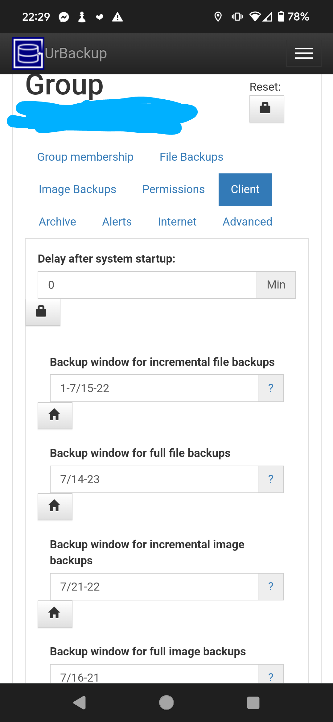

You might also find that you are best/better off setting the server to “force” the settings on the server to the client/s or group/s so you have it centralised…
Click on the “show details” and it should give the per type backup scheduling (times for full and incrementals, for both file and image jobs) mine are set as groups, even though most only have one client in each…
(Setting them up as groups makes it really simple for when a client system is replaced, or has another server of the same type added…exclusions and inclusions are set on the group, for example…)

Yeah, groups make it (IMHO) so much quicker/easier/simpler to deal with things…
There is barely any additional work to set up a group [literally just add a group, then add your client/s to the group] and then you have a “centralised” location for updating any changes like exclusions or backup window/s and allows a rapid add if you have a client get replaced or rebuilt…
One thread that I had a couple of screenshots of my original setup is here:
(Normally do my UrBackup admin and posting here from my mobile, hence the looooong screenshots…)
Happy to discuss further…
Oh, just remembered that you can also have alerting set for a group [same as on a per-client setting, but, well, centralised] and therefore you could configure on a per-team or per-custy grouping, and just add their client/s to the group…
Same goes for the archive (though not really something I have played with, aside from manually setting one for archive, before it was replaced/rebuilt) and pretty much anything each client can be set…
