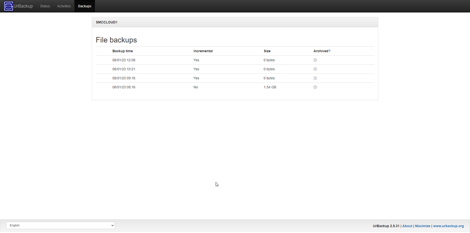

I have UrBackup rolling out in production with the server running on Ubuntu Server 22.04. Connected to LDAP for authentication with Duo 2FA authentication (but the issue happened without it as well). As a domain admin, I can see everyone’s backups and restore them without issue. But once I log in as a normal user I cannot see anything past the initial backup level to restore. I am also seeing all backed-up computers when I log in with my normal user, not just my computers. I’m happy to provide any logs that may help resolve this issue.
Update, I tried creating local users and that works perfectly. I do not want to go that route because per my CEO I need the Duo 2FA in place. I have the default “LDAP/AD class rights map” of “user==>lastacts={AUTOCLIENTS},progress={AUTOCLIENTS},status={AUTOCLIENTS},stop_backup={AUTOCLIENTS},start_backup=all,browse_backups=tokens”

I forgot to upload screenshots of the web UI. Please look at them for what I mean.
