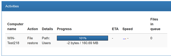

backup the C:\Users folder. Backup successful. Restore it, showed the above problem and UrbackupClientBackend Service stopped.
2017-01-04 16:54:07: WARNING: Info not found at ‘c:’ - reindexing
2017-01-04 16:54:21: ERROR: Recvfrom error in CUDPThread::UdpStep
2017-01-04 16:54:21: ERROR: Last error: 0
2017-01-04 16:55:11: ERROR: Recvfrom error in CUDPThread::UdpStep
2017-01-04 16:55:11: ERROR: Last error: 0
2017-01-04 17:00:51: ERROR: Recvfrom error in CUDPThread::UdpStep
2017-01-04 17:00:51: ERROR: Last error: 0
2017-01-04 17:05:02: ERROR: Recvfrom error in CUDPThread::UdpStep
2017-01-04 17:05:02: ERROR: Last error: 0
2017-01-04 17:05:09: ERROR: Error getting SID of ACE entry of file “\?\GLOBALROOT\Device\HarddiskVolumeShadowCopy4\Users\MY\AppData\Local\Application Data”
2017-01-04 17:05:09: ERROR: Error getting SID of ACE entry of file “\?\GLOBALROOT\Device\HarddiskVolumeShadowCopy4\Users\MY\AppData\Local\History”
2017-01-04 17:05:15: ERROR: Error getting SID of ACE entry of file “\?\GLOBALROOT\Device\HarddiskVolumeShadowCopy4\Users\MY\AppData\Local\Temporary Internet Files”
2017-01-04 17:05:15: ERROR: Error getting SID of ACE entry of file “\?\GLOBALROOT\Device\HarddiskVolumeShadowCopy4\Users\MY\Application Data”
2017-01-04 17:05:15: ERROR: Error getting SID of ACE entry of file “\?\GLOBALROOT\Device\HarddiskVolumeShadowCopy4\Users\MY\Cookies”
2017-01-04 17:05:19: ERROR: Error getting SID of ACE entry of file “\?\GLOBALROOT\Device\HarddiskVolumeShadowCopy4\Users\MY\Documents\My Music”
2017-01-04 17:05:19: ERROR: Error getting SID of ACE entry of file “\?\GLOBALROOT\Device\HarddiskVolumeShadowCopy4\Users\MY\Documents\My Pictures”
2017-01-04 17:05:19: ERROR: Error getting SID of ACE entry of file “\?\GLOBALROOT\Device\HarddiskVolumeShadowCopy4\Users\MY\Documents\My Videos”
2017-01-04 17:05:19: ERROR: Error getting SID of ACE entry of file “\?\GLOBALROOT\Device\HarddiskVolumeShadowCopy4\Users\MY\Local Settings”
2017-01-04 17:05:19: ERROR: Error getting SID of ACE entry of file “\?\GLOBALROOT\Device\HarddiskVolumeShadowCopy4\Users\MY\My Documents”
2017-01-04 17:05:19: ERROR: Error getting SID of ACE entry of file “\?\GLOBALROOT\Device\HarddiskVolumeShadowCopy4\Users\MY\NetHood”
2017-01-04 17:05:19: ERROR: Error getting SID of ACE entry of file “\?\GLOBALROOT\Device\HarddiskVolumeShadowCopy4\Users\MY\PrintHood”
2017-01-04 17:05:19: ERROR: Error getting SID of ACE entry of file “\?\GLOBALROOT\Device\HarddiskVolumeShadowCopy4\Users\MY\Recent”
2017-01-04 17:05:19: ERROR: Error getting SID of ACE entry of file “\?\GLOBALROOT\Device\HarddiskVolumeShadowCopy4\Users\MY\SendTo”
2017-01-04 17:05:19: ERROR: Error getting SID of ACE entry of file “\?\GLOBALROOT\Device\HarddiskVolumeShadowCopy4\Users\MY\Start Menu”
2017-01-04 17:05:19: ERROR: Error getting SID of ACE entry of file “\?\GLOBALROOT\Device\HarddiskVolumeShadowCopy4\Users\MY\Templates”
2017-01-04 17:07:36: ERROR: Error getting SID of ACE entry of file “\?\GLOBALROOT\Device\HarddiskVolumeShadowCopy6\Users\MY\AppData\Local\Application Data”
2017-01-04 17:07:36: ERROR: Error getting SID of ACE entry of file “\?\GLOBALROOT\Device\HarddiskVolumeShadowCopy6\Users\MY\AppData\Local\History”
2017-01-04 17:07:43: ERROR: Error getting SID of ACE entry of file “\?\GLOBALROOT\Device\HarddiskVolumeShadowCopy6\Users\MY\AppData\Local\Temporary Internet Files”
2017-01-04 17:07:43: ERROR: Error getting SID of ACE entry of file “\?\GLOBALROOT\Device\HarddiskVolumeShadowCopy6\Users\MY\Application Data”
2017-01-04 17:07:43: ERROR: Error getting SID of ACE entry of file “\?\GLOBALROOT\Device\HarddiskVolumeShadowCopy6\Users\MY\Cookies”
2017-01-04 17:07:47: ERROR: Error getting SID of ACE entry of file “\?\GLOBALROOT\Device\HarddiskVolumeShadowCopy6\Users\MY\Documents\My Music”
2017-01-04 17:07:47: ERROR: Error getting SID of ACE entry of file “\?\GLOBALROOT\Device\HarddiskVolumeShadowCopy6\Users\MY\Documents\My Pictures”
2017-01-04 17:07:47: ERROR: Error getting SID of ACE entry of file “\?\GLOBALROOT\Device\HarddiskVolumeShadowCopy6\Users\MY\Documents\My Videos”
2017-01-04 17:07:47: ERROR: Error getting SID of ACE entry of file “\?\GLOBALROOT\Device\HarddiskVolumeShadowCopy6\Users\MY\Local Settings”
2017-01-04 17:07:47: ERROR: Error getting SID of ACE entry of file “\?\GLOBALROOT\Device\HarddiskVolumeShadowCopy6\Users\MY\My Documents”
2017-01-04 17:07:47: ERROR: Error getting SID of ACE entry of file “\?\GLOBALROOT\Device\HarddiskVolumeShadowCopy6\Users\MY\NetHood”
2017-01-04 17:07:47: ERROR: Error getting SID of ACE entry of file “\?\GLOBALROOT\Device\HarddiskVolumeShadowCopy6\Users\MY\PrintHood”
2017-01-04 17:07:47: ERROR: Error getting SID of ACE entry of file “\?\GLOBALROOT\Device\HarddiskVolumeShadowCopy6\Users\MY\Recent”
2017-01-04 17:07:47: ERROR: Error getting SID of ACE entry of file “\?\GLOBALROOT\Device\HarddiskVolumeShadowCopy6\Users\MY\SendTo”
2017-01-04 17:07:47: ERROR: Error getting SID of ACE entry of file “\?\GLOBALROOT\Device\HarddiskVolumeShadowCopy6\Users\MY\Start Menu”
2017-01-04 17:07:47: ERROR: Error getting SID of ACE entry of file “\?\GLOBALROOT\Device\HarddiskVolumeShadowCopy6\Users\MY\Templates”
2017-01-04 17:08:23: ERROR: Recvfrom error in CUDPThread::UdpStep
2017-01-04 17:08:23: ERROR: Last error: 0
2017-01-04 17:09:13: ERROR: Recvfrom error in CUDPThread::UdpStep
2017-01-04 17:09:13: ERROR: Last error: 0
2017-01-04 17:09:33: ERROR: Recvfrom error in CUDPThread::UdpStep
2017-01-04 17:09:33: ERROR: Last error: 0
2017-01-04 17:09:38: ERROR: Error getting SID of ACE entry of file “\?\GLOBALROOT\Device\HarddiskVolumeShadowCopy7\Users\All Users”
2017-01-04 17:09:38: ERROR: Error getting SID of ACE entry of file “\?\GLOBALROOT\Device\HarddiskVolumeShadowCopy7\Users\Default\AppData\Local\Application Data”
2017-01-04 17:09:38: ERROR: Error getting SID of ACE entry of file “\?\GLOBALROOT\Device\HarddiskVolumeShadowCopy7\Users\Default\AppData\Local\History”
2017-01-04 17:09:38: ERROR: Error getting SID of ACE entry of file “\?\GLOBALROOT\Device\HarddiskVolumeShadowCopy7\Users\Default\AppData\Local\Temporary Internet Files”
2017-01-04 17:09:38: ERROR: Error getting SID of ACE entry of file “\?\GLOBALROOT\Device\HarddiskVolumeShadowCopy7\Users\Default\Application Data”
2017-01-04 17:09:38: ERROR: Error getting SID of ACE entry of file “\?\GLOBALROOT\Device\HarddiskVolumeShadowCopy7\Users\Default\Cookies”
2017-01-04 17:09:38: ERROR: Error getting SID of ACE entry of file “\?\GLOBALROOT\Device\HarddiskVolumeShadowCopy7\Users\Default\Documents\My Music”
2017-01-04 17:09:38: ERROR: Error getting SID of ACE entry of file “\?\GLOBALROOT\Device\HarddiskVolumeShadowCopy7\Users\Default\Documents\My Pictures”
2017-01-04 17:09:38: ERROR: Error getting SID of ACE entry of file “\?\GLOBALROOT\Device\HarddiskVolumeShadowCopy7\Users\Default\Documents\My Videos”
2017-01-04 17:09:38: ERROR: Error getting SID of ACE entry of file “\?\GLOBALROOT\Device\HarddiskVolumeShadowCopy7\Users\Default\Local Settings”
2017-01-04 17:09:38: ERROR: Error getting SID of ACE entry of file “\?\GLOBALROOT\Device\HarddiskVolumeShadowCopy7\Users\Default\My Documents”
2017-01-04 17:09:38: ERROR: Error getting SID of ACE entry of file “\?\GLOBALROOT\Device\HarddiskVolumeShadowCopy7\Users\Default\NetHood”
2017-01-04 17:09:38: ERROR: Error getting SID of ACE entry of file “\?\GLOBALROOT\Device\HarddiskVolumeShadowCopy7\Users\Default\PrintHood”
2017-01-04 17:09:38: ERROR: Error getting SID of ACE entry of file “\?\GLOBALROOT\Device\HarddiskVolumeShadowCopy7\Users\Default\Recent”
2017-01-04 17:09:38: ERROR: Error getting SID of ACE entry of file “\?\GLOBALROOT\Device\HarddiskVolumeShadowCopy7\Users\Default\SendTo”
2017-01-04 17:09:38: ERROR: Error getting SID of ACE entry of file “\?\GLOBALROOT\Device\HarddiskVolumeShadowCopy7\Users\Default\Start Menu”
2017-01-04 17:09:38: ERROR: Error getting SID of ACE entry of file “\?\GLOBALROOT\Device\HarddiskVolumeShadowCopy7\Users\Default\Templates”
2017-01-04 17:09:38: ERROR: Error getting SID of ACE entry of file “\?\GLOBALROOT\Device\HarddiskVolumeShadowCopy7\Users\Default User”
2017-01-04 17:09:38: ERROR: Error getting SID of ACE entry of file “\?\GLOBALROOT\Device\HarddiskVolumeShadowCopy7\Users\MY\AppData\Local\Application Data”
2017-01-04 17:09:38: ERROR: Error getting SID of ACE entry of file “\?\GLOBALROOT\Device\HarddiskVolumeShadowCopy7\Users\MY\AppData\Local\History”
2017-01-04 17:09:46: ERROR: Error getting SID of ACE entry of file “\?\GLOBALROOT\Device\HarddiskVolumeShadowCopy7\Users\MY\AppData\Local\Temporary Internet Files”
2017-01-04 17:09:46: ERROR: Error getting SID of ACE entry of file “\?\GLOBALROOT\Device\HarddiskVolumeShadowCopy7\Users\MY\Application Data”
2017-01-04 17:09:46: ERROR: Error getting SID of ACE entry of file “\?\GLOBALROOT\Device\HarddiskVolumeShadowCopy7\Users\MY\Cookies”
2017-01-04 17:09:50: ERROR: Error getting SID of ACE entry of file “\?\GLOBALROOT\Device\HarddiskVolumeShadowCopy7\Users\MY\Documents\My Music”
2017-01-04 17:09:50: ERROR: Error getting SID of ACE entry of file “\?\GLOBALROOT\Device\HarddiskVolumeShadowCopy7\Users\MY\Documents\My Pictures”
2017-01-04 17:09:50: ERROR: Error getting SID of ACE entry of file “\?\GLOBALROOT\Device\HarddiskVolumeShadowCopy7\Users\MY\Documents\My Videos”
2017-01-04 17:09:50: ERROR: Error getting SID of ACE entry of file “\?\GLOBALROOT\Device\HarddiskVolumeShadowCopy7\Users\MY\Local Settings”
2017-01-04 17:09:50: ERROR: Error getting SID of ACE entry of file “\?\GLOBALROOT\Device\HarddiskVolumeShadowCopy7\Users\MY\My Documents”
2017-01-04 17:09:50: ERROR: Error getting SID of ACE entry of file “\?\GLOBALROOT\Device\HarddiskVolumeShadowCopy7\Users\MY\NetHood”
2017-01-04 17:09:50: ERROR: Error getting SID of ACE entry of file “\?\GLOBALROOT\Device\HarddiskVolumeShadowCopy7\Users\MY\PrintHood”
2017-01-04 17:09:50: ERROR: Error getting SID of ACE entry of file “\?\GLOBALROOT\Device\HarddiskVolumeShadowCopy7\Users\MY\Recent”
2017-01-04 17:09:50: ERROR: Error getting SID of ACE entry of file “\?\GLOBALROOT\Device\HarddiskVolumeShadowCopy7\Users\MY\SendTo”
2017-01-04 17:09:50: ERROR: Error getting SID of ACE entry of file “\?\GLOBALROOT\Device\HarddiskVolumeShadowCopy7\Users\MY\Start Menu”
2017-01-04 17:09:50: ERROR: Error getting SID of ACE entry of file “\?\GLOBALROOT\Device\HarddiskVolumeShadowCopy7\Users\MY\Templates”
2017-01-04 17:09:50: ERROR: Error getting SID of ACE entry of file “\?\GLOBALROOT\Device\HarddiskVolumeShadowCopy7\Users\Public\Documents\My Music”
2017-01-04 17:09:50: ERROR: Error getting SID of ACE entry of file “\?\GLOBALROOT\Device\HarddiskVolumeShadowCopy7\Users\Public\Documents\My Pictures”
2017-01-04 17:09:50: ERROR: Error getting SID of ACE entry of file “\?\GLOBALROOT\Device\HarddiskVolumeShadowCopy7\Users\Public\Documents\My Videos”
2017-01-04 17:09:53: ERROR: Error getting SID of ACE entry of file “\?\GLOBALROOT\Device\HarddiskVolumeShadowCopy7\ProgramData\Application Data”
2017-01-04 17:09:53: ERROR: Error getting SID of ACE entry of file “\?\GLOBALROOT\Device\HarddiskVolumeShadowCopy7\ProgramData\Desktop”
2017-01-04 17:09:53: ERROR: Error getting SID of ACE entry of file “\?\GLOBALROOT\Device\HarddiskVolumeShadowCopy7\ProgramData\Documents”
2017-01-04 17:09:53: ERROR: Error getting SID of ACE entry of file “\?\GLOBALROOT\Device\HarddiskVolumeShadowCopy7\ProgramData\Favorites”
2017-01-04 17:09:56: ERROR: Error getting SID of ACE entry of file “\?\GLOBALROOT\Device\HarddiskVolumeShadowCopy7\ProgramData\Start Menu”
2017-01-04 17:09:56: ERROR: Error getting SID of ACE entry of file “\?\GLOBALROOT\Device\HarddiskVolumeShadowCopy7\ProgramData\Templates”
2017-01-04 17:11:00: ERROR: Fatal exception code 3765269347 at address 0x000007FEFDAAAA7D
2017-01-04 17:11:02: ERROR: Fatal exception (APPLICATION CRASHED). Crash dump written to “C:\Windows\TEMP\UrBackup\v2.0.0-20170104-171100-1456-2820.dmp”
2017-01-04 17:11:02: ERROR: Program abort (SIGABRT)strong text
